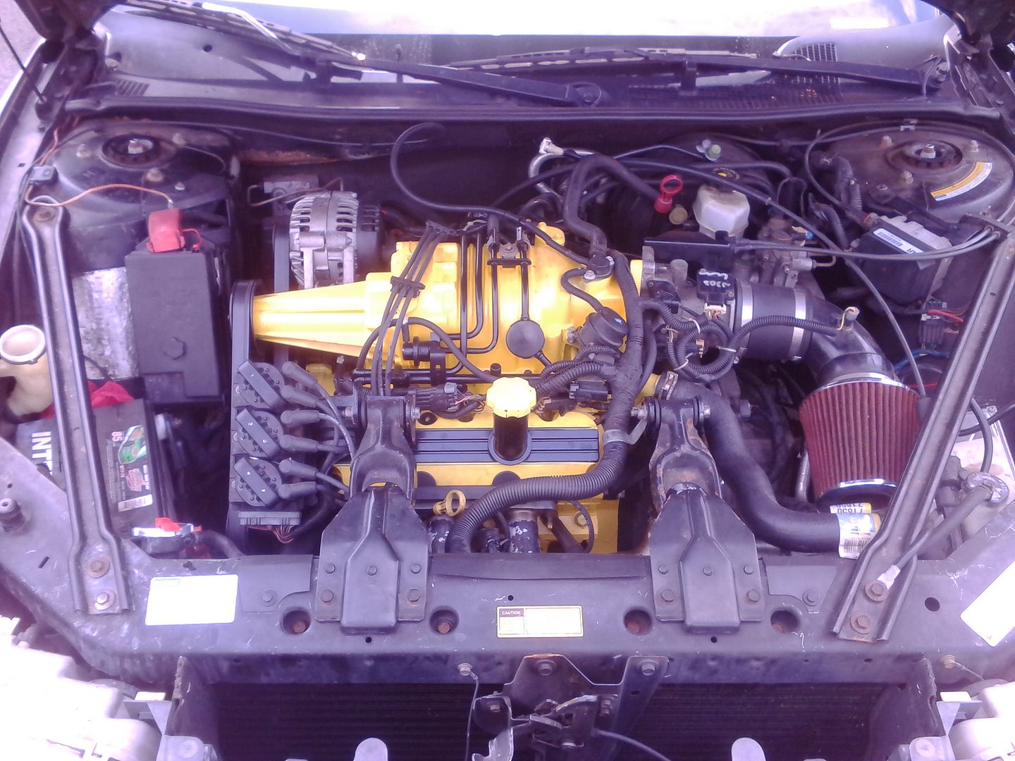

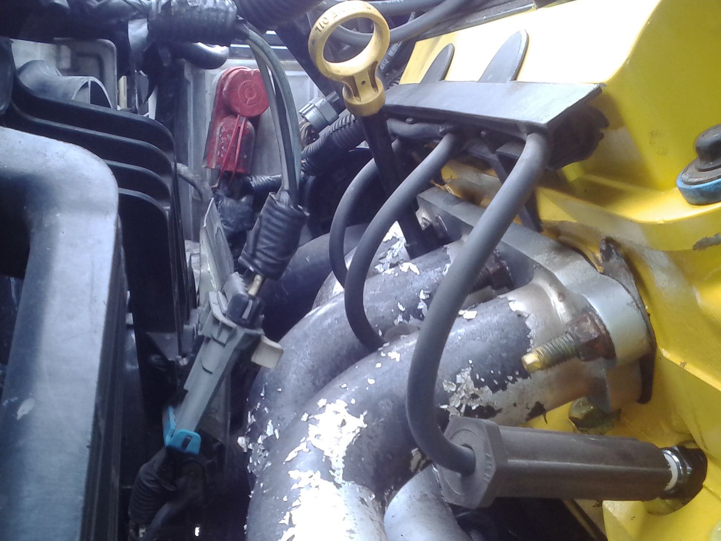

    ive since had the front cover recall done, that plug wire holder still works on the new cover. it makes the wires look cleaner and keeps them away form things.
    i made the dealer return it to me, they tossed it in the trash, mean while my wires were touching the fan blades. they used nothing to control the wires. just like yours all over the damn place.
    top of the blower on the snout theres a small bracket bolted on with a hole in it, the plug wires should clip into it via the wire holders. ive got mine in order 2,4,6 so when i change or check plugs i lay the rear wires in place and they are in order already. in the back its one more wire holder thats holding the wires taunt so they cant touch anything back there.
    found it, pic of new vc and plug wire holder. a load of mods added had to re route the rear wires so they didnt get pinched by the hood. ive ran out of room why the paints rubbed off some.

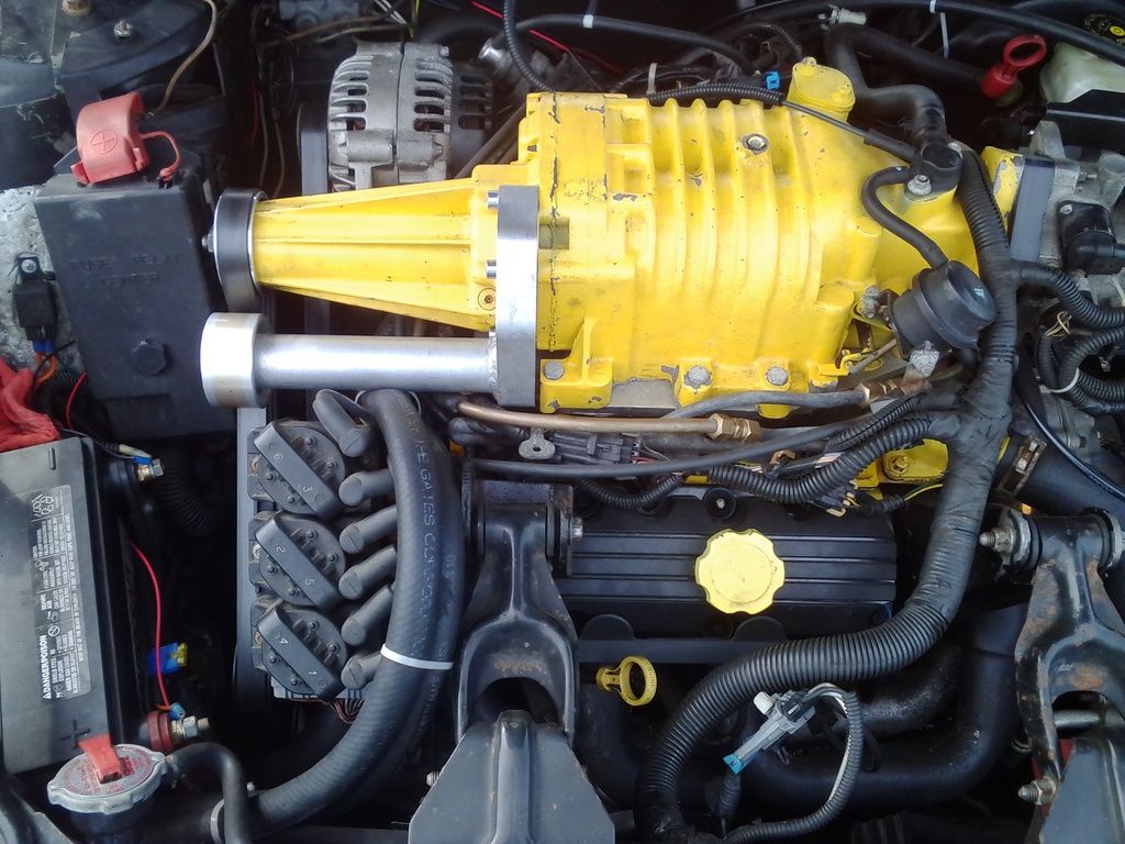

    if not any parts store brand will work just fine as well. its all most of us use. whats in my pics. cheap wires, ran me 30 ish iirc a number of years ago now.
