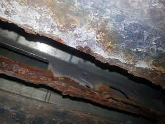

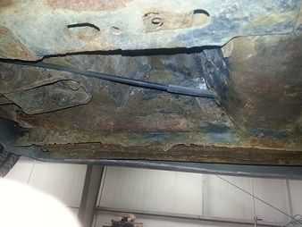

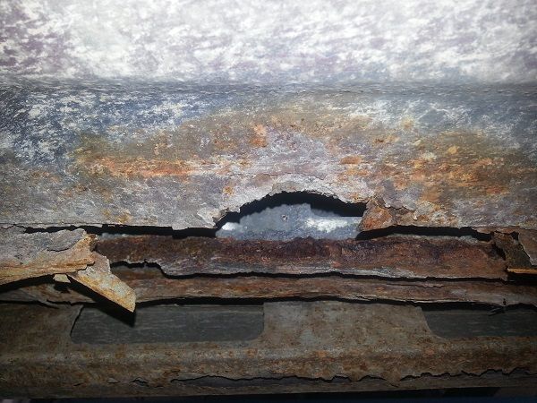

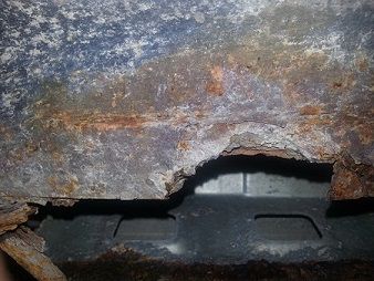

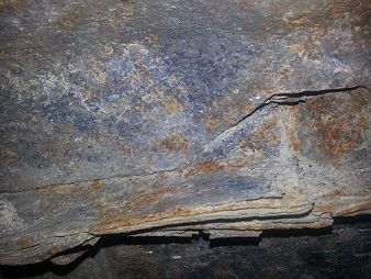

    Here are the Pictures. Just to let you know. A body shop said there was Zero Rocker Panels Left. I am going to go back to the dealership and ask how this passed the initial Safety before being sold to me.

    Obviously, I knew about some Rocker Panel rust. But not to the extent that it was. They had a patch job on it that was only spot welded on one side. Nothing holding the patch to the car. And once that was removed as it was falling off anyways, that is when all the other stuff was disintegrated. That is more than a years worth of damage. Even for a Canadian Winter. Love it when Americans think they know a bit more that others. Atleast I don't put "VET" in my Name. I do not have to show off that I am a Vet. Just saying.
