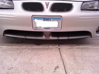

    i just bought this car not to long ago and its starting to warm up so i decided id start cleaning and getting it to look the way it should. so the first project of many are these stripes on my lower frount bumper. there smooth and i havnt taken any kind of cleaner to them yet i was just wondering if this is normall.
    http://i702.photobucket.com/albums/w...owerbumper.jpg
    sorry i couldnt upload it directly. i couldnt figure it out. help on that would be great as well because im sure ill have to do that again.

    I'm curious what causes those. You haven't taken any cleaner to them though. I wash my car at least every other week so I never really notice stripes, and if it's a paint problem it hasn't effected my car at 135k miles.

    I'm wondering if that has anything to do directly with the airflow through the slits in the front bumper. I'm thinking that is the high traffic zone for the air to pass through with higher pressure, resulting in the debris to stick. My guess, and it's just a guess, is the stripes are mostly salt. Dirt and other debris stick on your car but salt sticks real good.
    I doubt you'd do it and not even sure I recommend it without further investigation, but maybe give it a little taste, haha.

    those are cracks in your bumper, it comes through the paint. even if you paint over them they will show up again.

    I guess not... if those are cracks you have a few options.
    1.Could probably have a body shop fix it
    2. Get a new front bumper and have it painted, or
    3. (What I would do) get the SD Air Dam, put that sucker over it and have it repainted... oh yea! You have an excuse, haha, take advantage of it.

    the only way is to take it to a body shop so they can put fiberglass over the cracks and repaint it, or get a new bumper its up to you. you can repaint it again without fiberglass but the cracks will show up again eventualy..

    you can get the sd air dam at grandprixstore.com... but you would have to paint that to match your car color also. i had the same problem on my gp I painted it twice and the cracks just came back...so i got a new bumper problem fixed. fiberglass will work too just take it to a good body shop..

    i wouldnt recomend that you paint over the cracks with out puting fiberglass because the cracks will show up again do it rite the first time...dont be like me i had to do it twice waste of money but its all up to you...
