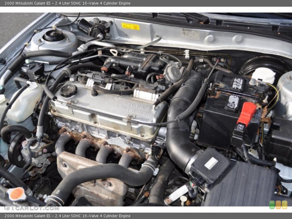

    Yeah chilton is not very specific. The eclipse might be the right one, but there actually isnt a head gasket R&R for it... Is this the engine by chance?
    Sold.

    the engine is pretty much like that but it says 2.4L mitsubushi on it.

    im wrong here it is
