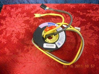

    yeah i hope you didn't spin the wheel around like a kid on an amusement park ride, or you just tossed out a nice chunk of money, the clock springs not cheap.
  15. #15 Re: Steering wheel spins freely, what broke?
    Florida
    168
    That is exactly the part of the shaft that I was talking about having come apart.
    I forgot that you likely would have to lower the cradle a little. I did it on Chris's but not on Mikes. You can do it with two people w/o taking the shaft off the steering column with two people in the way I described it. The only potential issue you have here is if you turned the steering wheel too far when they were disconnected, it would damage the clock spring. You'll know once it's back together if that happened, because your airbag and steering controls won't work.
    I turned it a few times, then back to where it was once I figured out it wasn't working. Any way to check this besides putting them all back together? Which steering controls are you referring to, like the stereo controls? If they work now that means I'm good?
  16. #16 Re: Steering wheel spins freely, what broke?
    just make sure you have the wheel back to where it was when you started, if you went 2 full turns in any direction or less you should be ok, if you went more than 3 full turns good chance its toast.
    the clock spring is located under the steering wheel, if you broke it your airbag light will come on and your radio controls for the steering wheel will not work.
    so if none of that happens you'll be ok.
  17. #17 Re: Steering wheel spins freely, what broke?
    Florida
    168
    So if my airbag light isn't on and my radio controls work, I'm fine, right?
  18. #18 Re: Steering wheel spins freely, what broke?
    Quote Originally Posted by aeidian View Post
    correct!
  19. #19 Re: Steering wheel spins freely, what broke?
    Florida
    168
    Scratch that, I thought the light wasn't on, but I just checked and both the SRS light is on and the radio controls don't work. There a write up on how to fix this that you all can point me too?
  20. #20 Re: Steering wheel spins freely, what broke?
    not that ive seen here.
    i did mine, it wa sin a regal, close enough tho.
    you need to remove the battery cable first. then remove the airbag from the wheel, how you remove it on a gp i dont really know.
    the take the steering wheel off, you will need a puller to get it off. also un clip the radio controls before the wheel comes off. and the horn ground, you push it in and tun it, it comes right out.
    then take the plastic off the top and bottom of the column, regal had a torx screw on the bottom and the back side was kinda a hinge clip. gp im not 100 % sure.
    now that all that's out of the way, you will see the clock spring, it has a spring clip holding it in place, remove that and it comes out.
    at the bottom of the dash, where the obd2 port is, if you look next to it, you will see a yellow plug and a black plug right next to each other, un plug them both, those are from the clock spring. you may need to take the lower plastic and steel knee bolster off to get the zip ties cut off the old clock springs wires from the rest of them, mine had 2 zip ties holding them all together.
    once out it looks like this.
