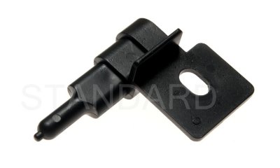

    367
    My temp. display in my rearview mirror reads way too low. In the summer, itll be 75 degrees and itll read something ridiculous like 52. Does anyone know where the sensor is. I was thinking under the bumper. I want to replace it

    Ambient temp sensor is about where you were thinking. Get underneath the bumper and look up past the bumper "splitter" on the passenger side. Its clipped to the air ductwork, I believe. Near where the lower unibody rail meets the impact bar. If you see the parts guy drop it on the way to the counter, ask for another. They can be failure prone but are inexpensive.

    Yep air ducting behind the bumper, thats it. Look at the backside of the impact bar. I've always bought GM ones. Some live, some don't. Simple as that. They usually stick on one temp in my experience. If it sticks at 37 degrees or below it will prevent the compressor from switching on.

    take that plastic off in front of the rad between the bumper, if you have it. look down its mounted on a bar down there.
    looks like this

    well i got the part as pictured above and its really cold outside so i tried limiting my time out there. i saw the old one is held in with a plastic clip. so do i just pull down on the old unit until the clip comes free or is there some other way?
