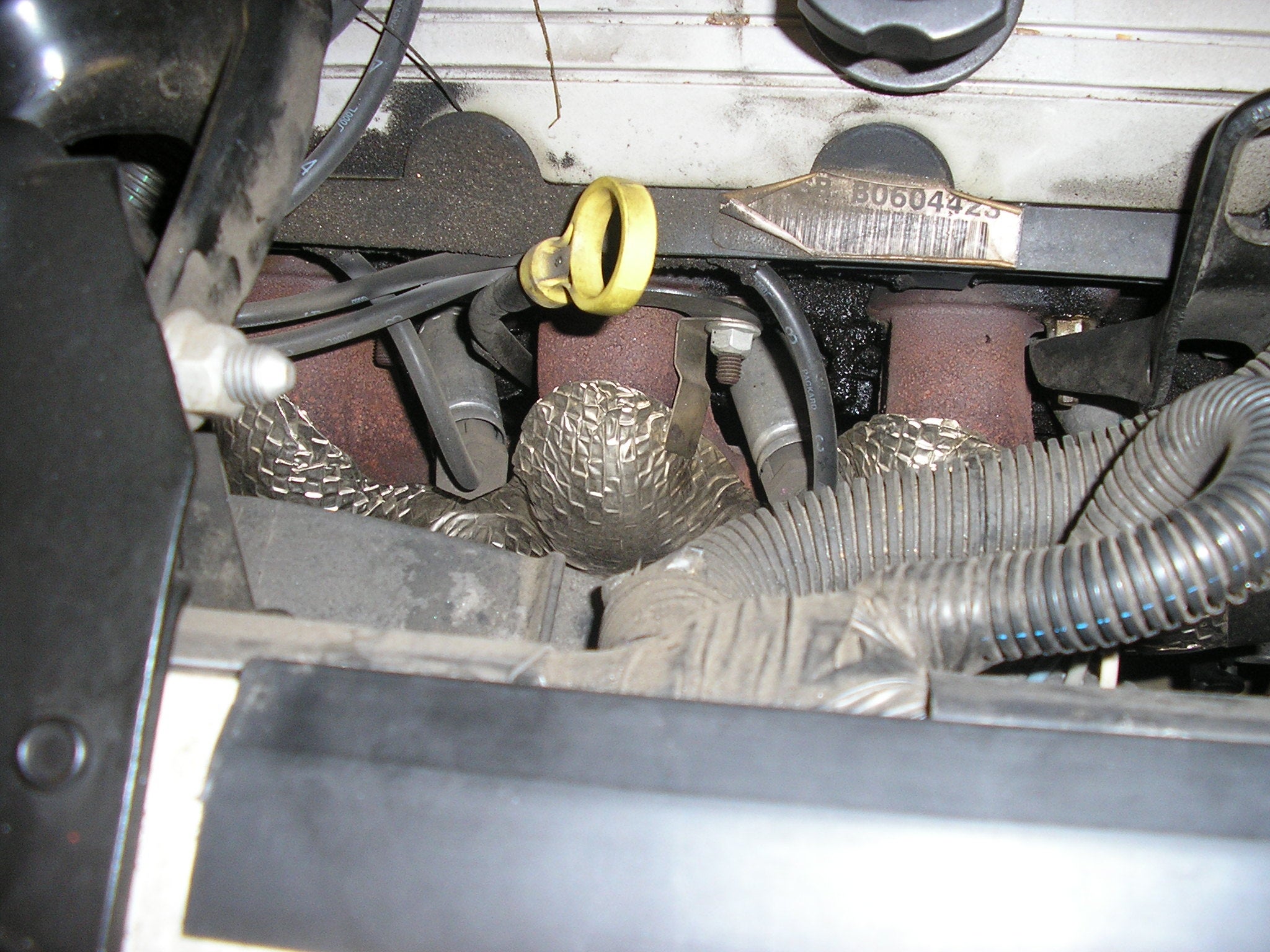

    * Valve cover gaskets – GM issued a recall for some models, but not all….and unfortunately they are usually all bad. Look for signs of weeping valve cover gaskets, usually moist with oil right under the valve cover on the cylinder head. You WILL need to replace these gaskets, not a hard job, definitely not a deal breaker either. If the leak is bad enough, you may also smell some burning oil, that’s usually from the rear bank valve cover dripping onto the exhaust manifold.
    This is a perfect example of what to look for:
