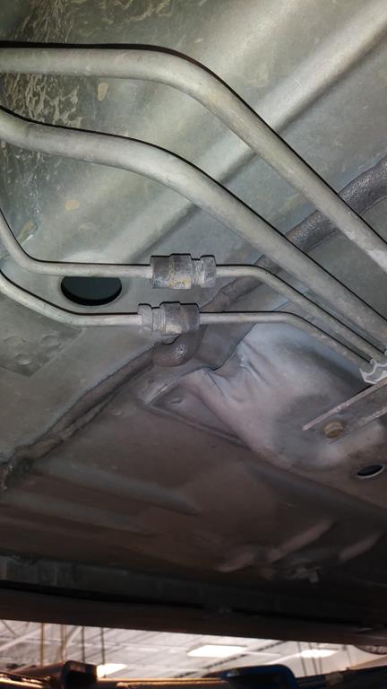

    So this is where I COULD possibly add the Dorman proportioning valves, but id have to know if the threads are the same and the flare type since Dorman has several listings but nothing specific for my car. That or I can order Baer Brakes Proportioning Valves 6801276 - Free Shipping on Orders Over $99 at Summit Racing from Summit and have adjustablitiy, will just have to spend time dialing it. Though even with this, id still need to know what fittings and flare type so I can order the correct ones before taking it all apart. Dont want to have to take it apart to find out before hand and end up having to bleed the brakes

    That's what your floors looks like ??? Me so jelly. I would eat my dinner off of those. DAY-um !

    Florida car
