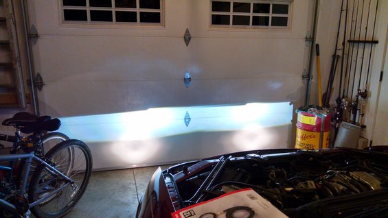

  18. #16 Re: Question about Headlights
    Donating Users gingerdude's Avatar
    Dec 2016
    IL
    181
    That is like night and day.
    I swapped my factory bulbs... yes literally the ones from the factory... for ExtremeVisions and did the fog light on with brights mod. That helped the lighting but there's definitely room for improvement. My lenses are in good shape too.
    01 GP SE 3.1

    Quote Originally Posted by gingerdude View Post
    ^ This. Retros give the best possible light. I never used to like the look of them, but now I wouldn't have my headlights any other way.
