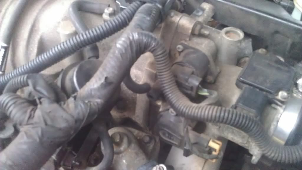

  6. #6 Re: mass air flow sensor?
    thats just a vacuum line off the evap, just buy some vacuum hose and replace it.
  7. #7 Re: mass air flow sensor?
    Replace that tubing...then see if your other stuff is bad...are you sure? What codes is your car throwing if any?
  8. #8 Re: mass air flow sensor?
    SE Level Member tcafego's Avatar
    Aug 2011
    taylor, mi
    46
    Anyone happen to know the part number or just the name of that broken hose? Autozo.e and oreillys really didn't really tell me anything but it leads to the evap purge solenoid
  9. #9 Re: mass air flow sensor?
    You can buy the entire vacuum set from your local dealership. Go there and have them pull up a picture of the L67 and say I want THAT *point at the vacuum line*
  10. #10 Re: mass air flow sensor?
    Aug 2011
    taylor, mi
    46
    Thanks will do
