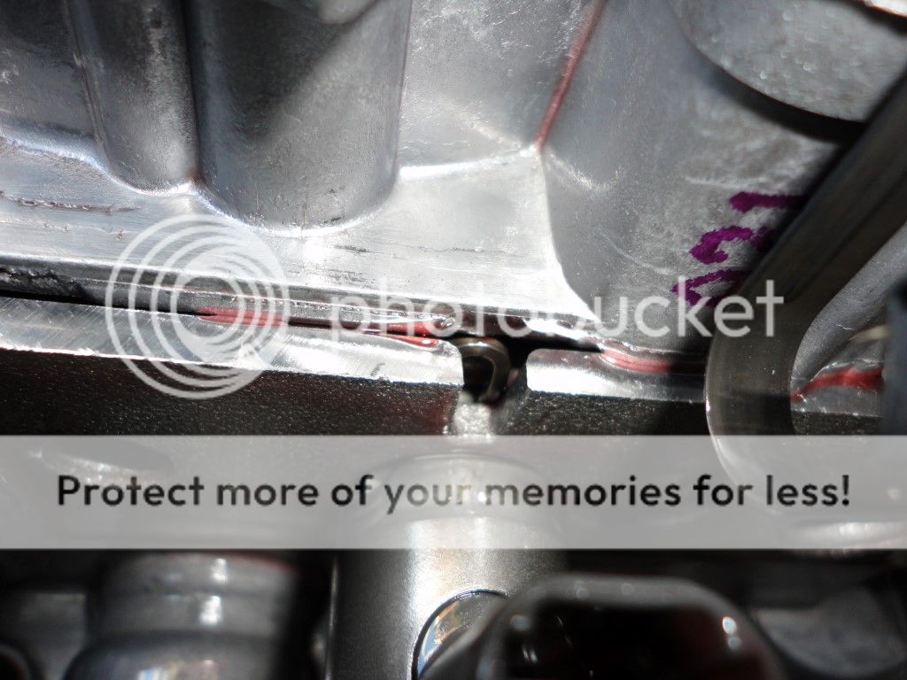

    Yeah cradle needs to be dropped, I don't even know how you can get the side cover off without doing so. Remove the two rack bolts that secure it to the sub frame, Loosen the right 2 sub frame bolts, remove the left two. While supporting the engine and trans of course. Bill's method was from above, I used a 2x4 spanning across both pans held by a floor jack. The rest is fairly obvious, get the cv axle, trans mount, and suspension stuff out of the way to make it easy. The only things under the hood you have to watch are the throttle cables, the trans cooler lines, and shift cable. And remove the upper mounts too. The ac line on the GT's just has to be pushed slightly out of the way, not bent or anything.
    You should check out the whole harness, he might have butchered it and left it. The clips often break. Yes there are clips you pull with a pick to get the solenoids out, I believe the pump has to be removed to do the TCC since the clip is behind it.
    Get the remaining torx out with a good bit and make sure no dirt is in the bolt, give it a tap with the hammer and use leverage if you have to. They don't usually strip if you can keep the extension straight. Luckily the heads are flat you you can get vice grips on it possibly.
    Side cover bolts
    There is nothing holding the subframe, it just swings freely as there is no more weight on it.
    Clip for the tcc solenoid, hidden behind the pump. If yours looks like this, remove the pump by removing all the bolts for it except the silver one.

    Oh I see he did it the hard way. Impressive. Anyway the clip is what holds the solenoid in, it likely popped out and caused slipping. see if you can find it first.
    Oh, and all bolts are made of steel. The transmission is aluminum. hopefully its not stripped.
