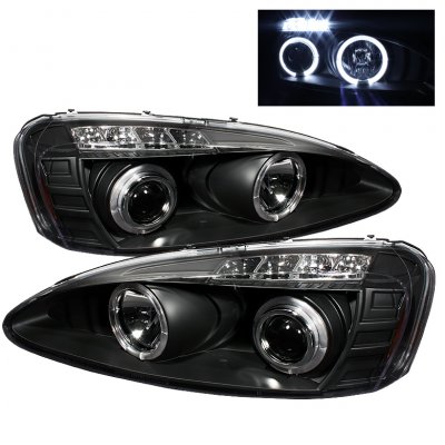

    The 04+ projectors are possible to retrofit, but it is no easy task. I did mine with the minis but still haven't got around to adjust the cutoff. I tinted the side marker and swapped out the led's too.

    if the 97-03 is possible, then the 04+ would be easy.

    Only reason it is not too easy is because the plastic melts before the sealant softens, so it is a bit of a challenge to open them without wrecking them. Other than that its awesome because it already has a good mounting system made for projectors.

    I've never had a problem with the plastic melting. The real problem is the plastic behind the headlight on the car that makes it hard to mount the projectors.

    I think he's talking about the ****ty aftermarket projector headlights.
